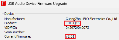

Q15 Bellenimleri
- XMOS: 2.01 (2024/08/29)
- Bluetooth: 0.36 Güncellenmedi

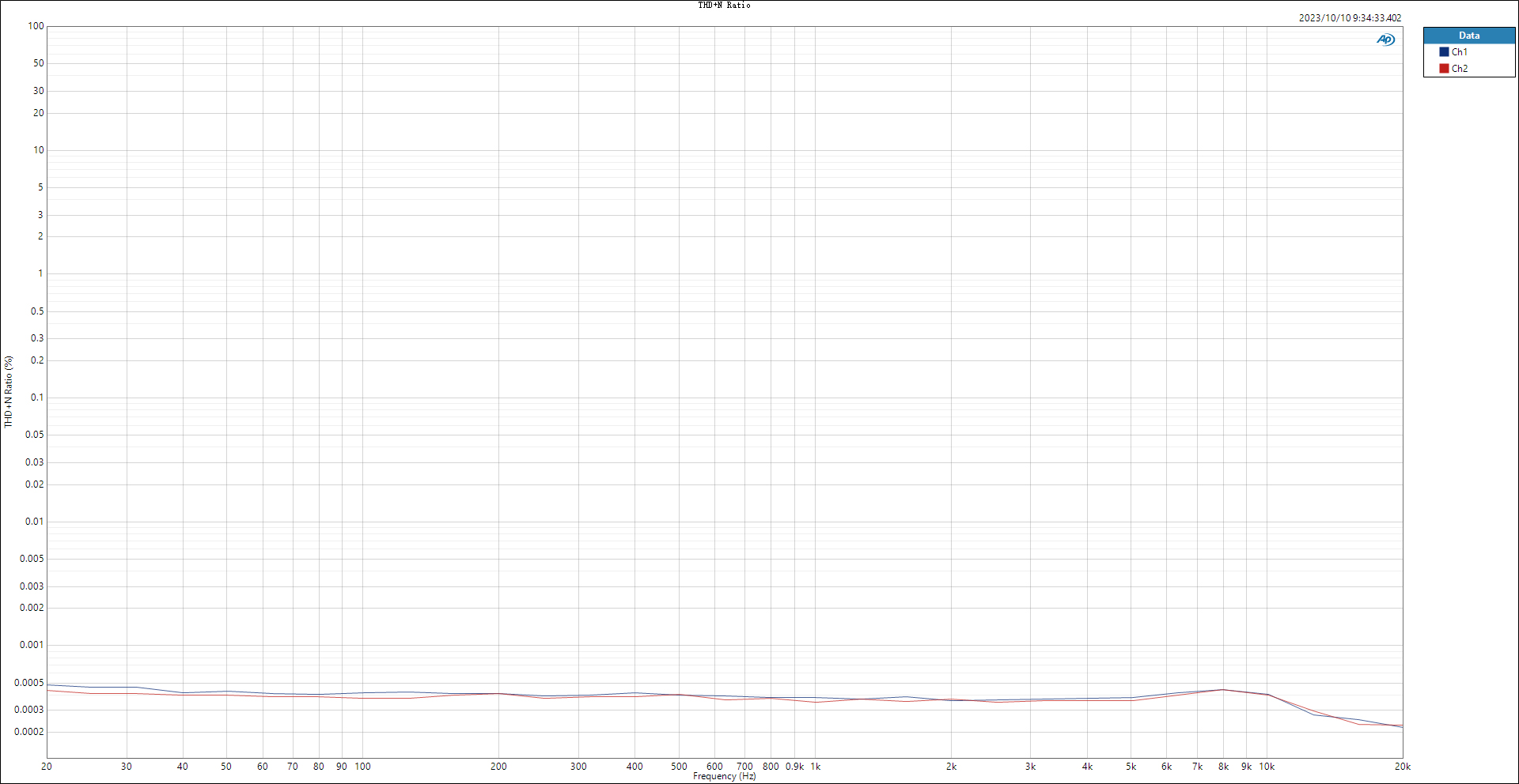

Parts of performance and parameters of headphone output (3.5mm out, USB DAC/Coaxial decoding, Ultra High Gain mode)
Output power:
- L+R≥750mW+750mW (16Ω, THD+N<1%)
- L+R≥625mW+625mW (32Ω, THD+N<1%)
- L+R≥85mW+85mW (300Ω,THD+N<1%)
Output impedance: <1Ω
Crosstalk: ≥ 72dB
Peak output voltage: 14.5Vp-p
SNR: ≥ 123dB (A-weighted)
Noise floor: <3.1uV (A-weighted)
THD+N & Noise:
- <0.0005%(1kHz/-9dB @ 32Ω)
- <0.0004%(1kHz/-6dB @ 300 Ω)
Frequency response:
- 20Hz~80kHz: damping<3dB
- 20Hz~20kHz: damping<0.1dB
